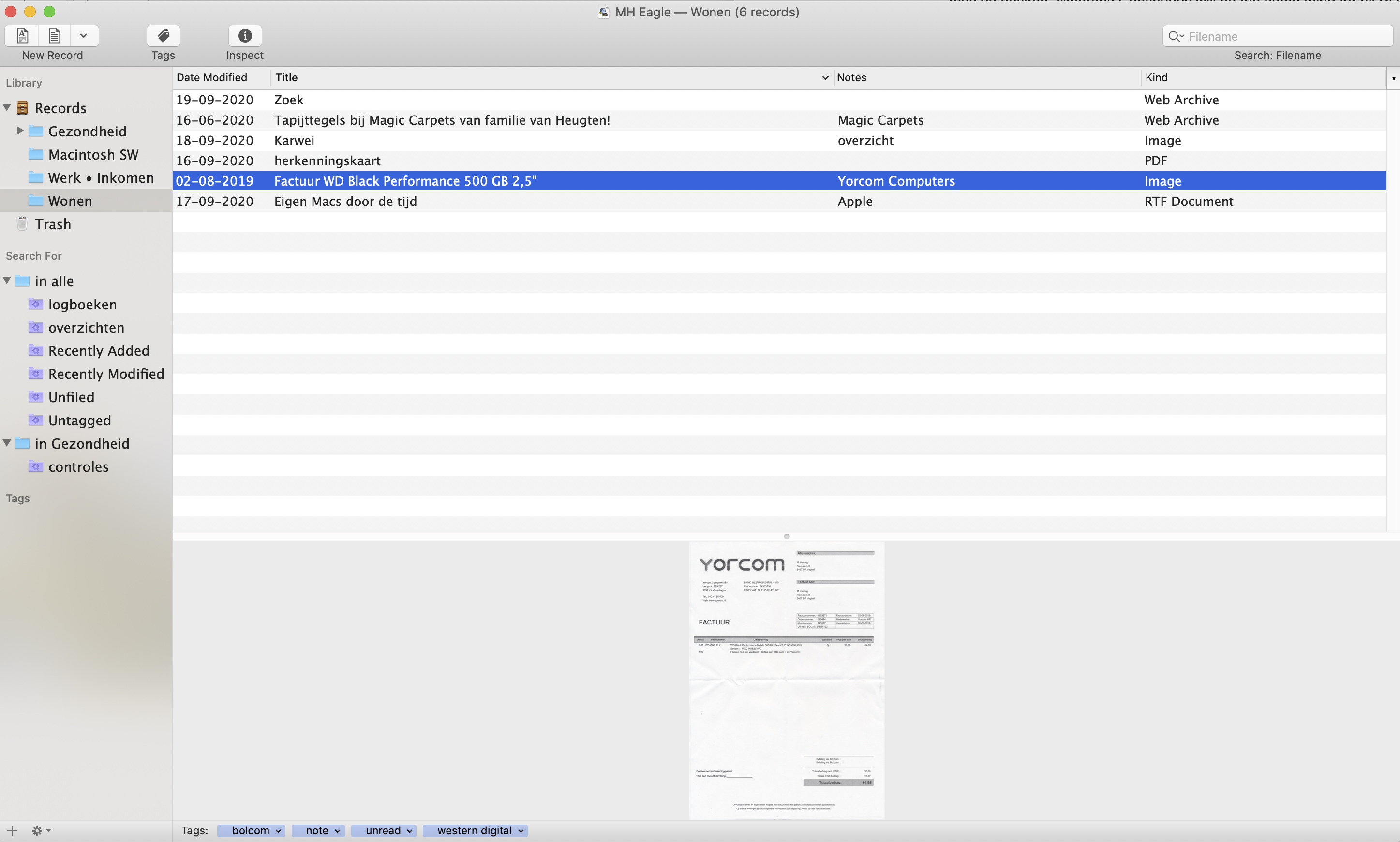

Another issue is displaying things in the Record Viewer (the lower pane of the EF window). RTF-texts and Web Archives are displayed in full width but Images and pdf’s as thumbnails, when selected. How to display these also in full width?

Do you have an example of an image file that is displayed too small? It may be that the image has a high DPI, and macOS is trying to show it at actual size. The DisplayImagesWithQuickLook and RespectImageDPI esoteric preferences may be helpful here.

What I mean with small images is that they fit vertical in the pane. I will examine your scripts to find a way I like.

It seems good to me that the image would be displayed such that it fits vertically. If you disagree, could you post (or e-mail) a screenshot so that I can see what you are referring to?

In this example an image (a scan of an invoice) is displayed as fitted vertically, but I suggested a horizontal fit like Webarchives, rtf-text and pdf’s (after Continuous mode) do.
Am I clear with this example?
Martien
Yes, that is clear. Thanks. Right now it is not possible to show less than the entire image except by double-clicking to open it in Preview. I do agree that a zoom-to-horizontal-fit option would make sense.
