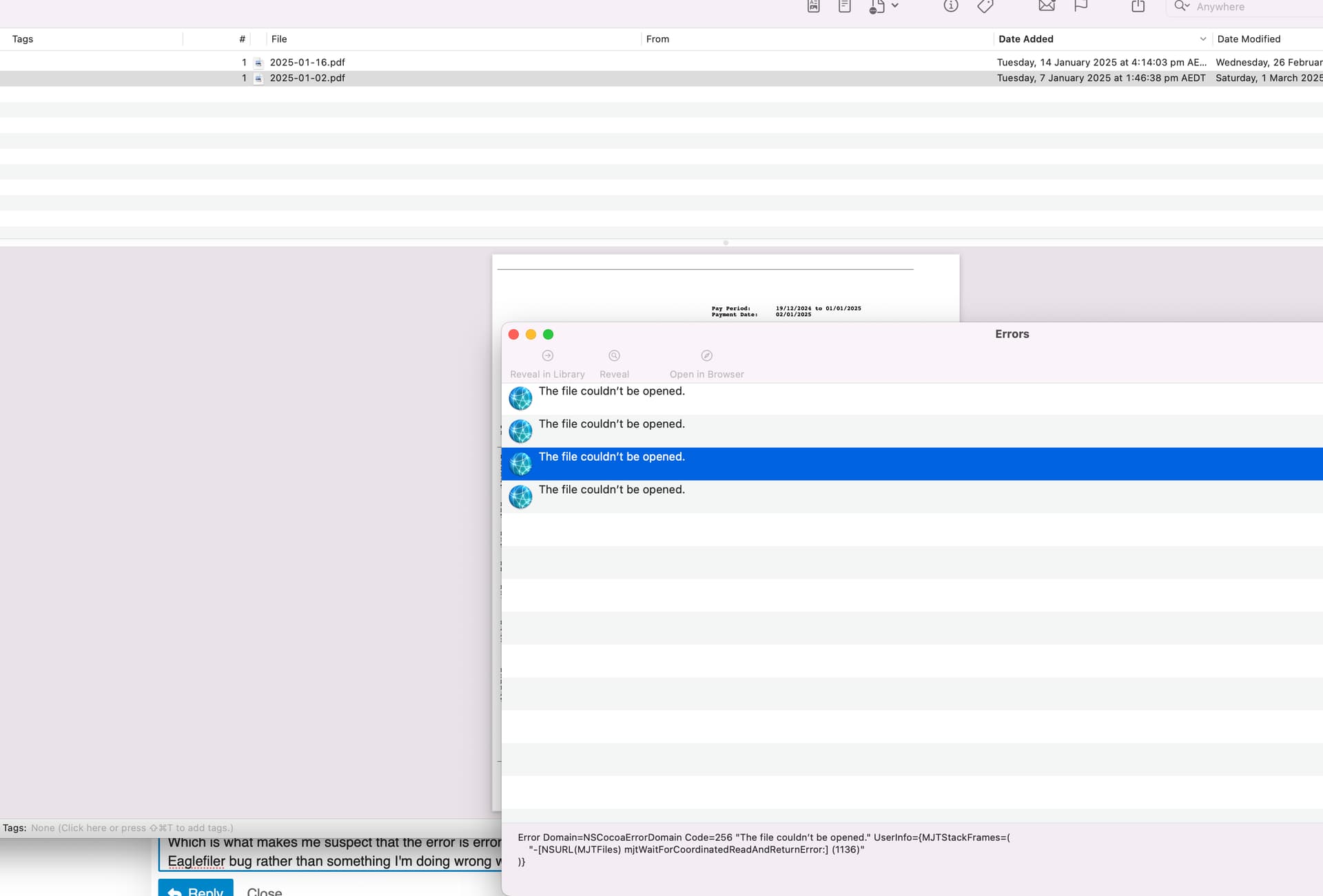

The alias appears and eaglefiler even seems able to read it, the preview of the pdf shows correctly as expected, but every time I click the file I get an error in the window “The file couldn’t be opened” with detail
Error Domain=NSCocoaErrorDomain Code=256 “The file couldn’t be opened.” UserInfo={MJTStackFrames=(
“-[NSURL(MJTFiles) mjtWaitForCoordinatedReadAndReturnError:] (1136)”

I click on the link/file and I see the preview. I double click the link/file and the file opens. But every time I click on the link, EagleFiler pops up the error. Which is what makes me suspect that the error is erroneous and it’s an Eaglefiler bug rather than something I’m doing wrong with the link. See the attached screenshot.
Ah, I thought you were reporting that the error was in the main window. This particular error in the Errors window can be ignored if the file displays correctly. I will try to dig into what’s causing it.
I think the error is fixed in EagleFiler 1.9.17b1.
