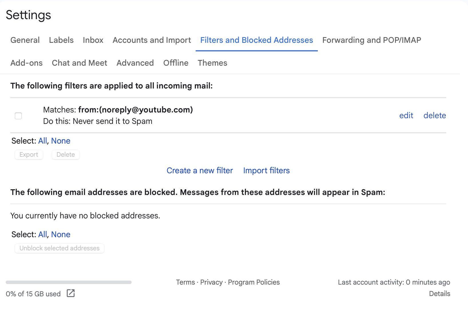

I’m pretty sure I have all filtering off in Gmail. This is what it looks like. Am I missing something?
The Apple Mail blocking feature moves the messages to the Junk mailbox.
Yes, there is no visible setting to turn off the Gmail spam filter. You have to specifically create a filter to do that.
