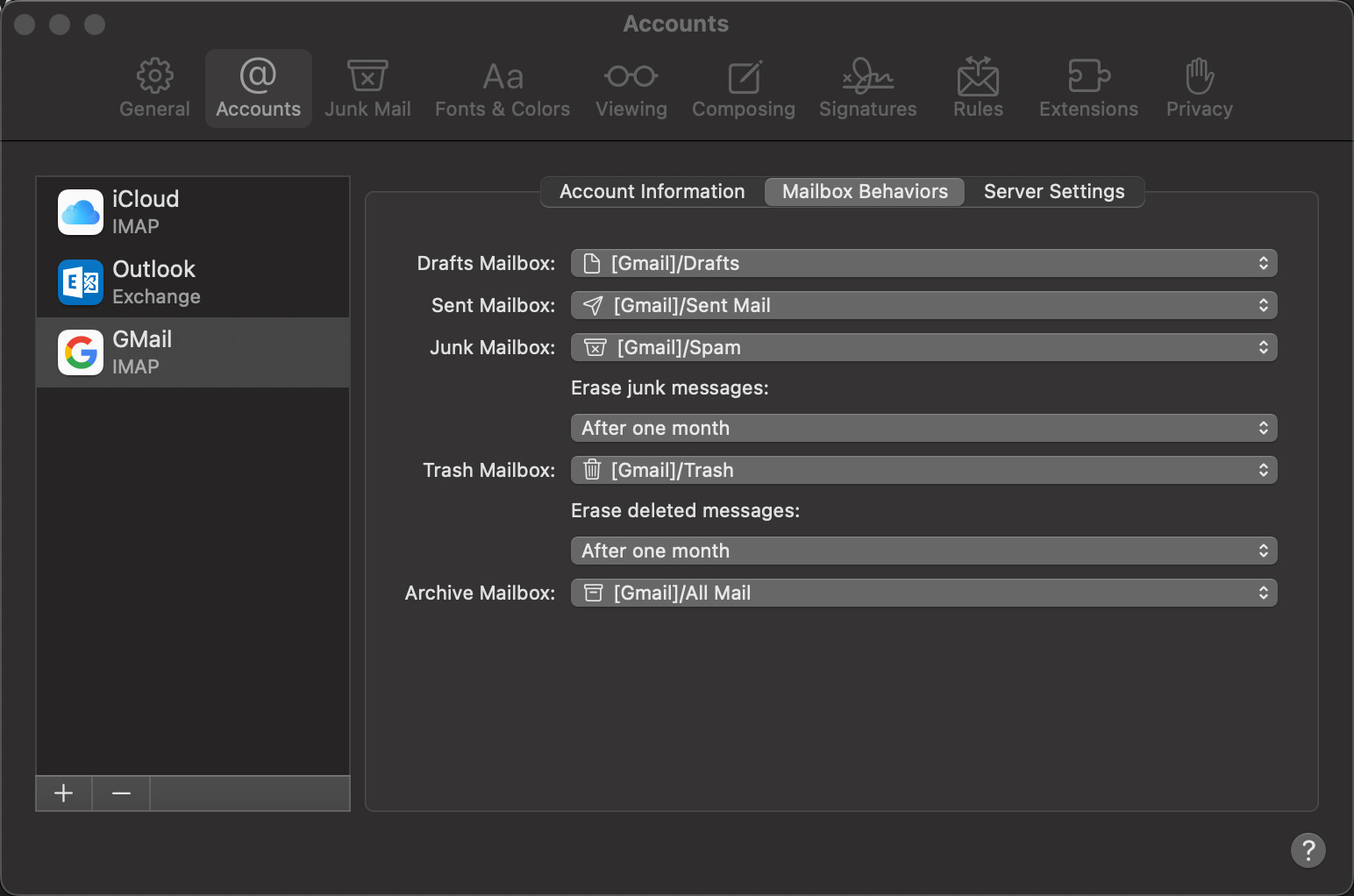

Which mailbox is set as the Junk mailbox in Mail’s Settings ‣ Accounts ‣ Mailbox Behaviors?
You only have to edit the script to add your account names if you don’t have SpamSieve set to use the Junk mailbox for training.
That looks correct. Does it help if you change the line:
property pMoveBySettingMailbox : true
at the top of the script to:
property pMoveBySettingMailbox : false

Ugh. I’m a moron. I had it set to Trash instead of Junk. Didn’t remember doing that. Thanks for your patience.
