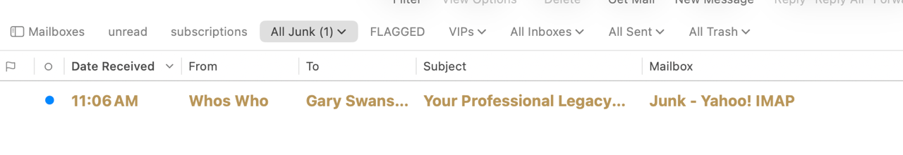

However, right now there is one email in All Junk which is dated 13 minutes ago, and the app is set to run every 5 minutes. Here’s a screenshot:
I opened the script editor and ran the script. The email was sent to the trash. But the app should have done that earlier.

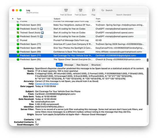

I was watching my Junk folder and noticed again something odd. There were 2 emails in Junk, not yet processed by the Rescue app. The newest disappeared to the trash, but the older one was untouched. 5 minutes later, 10 minutes after the email appeared, the older email was sent to Trash.
So the script app processed the newer one, skipped the older one, but then later processed the newer one.

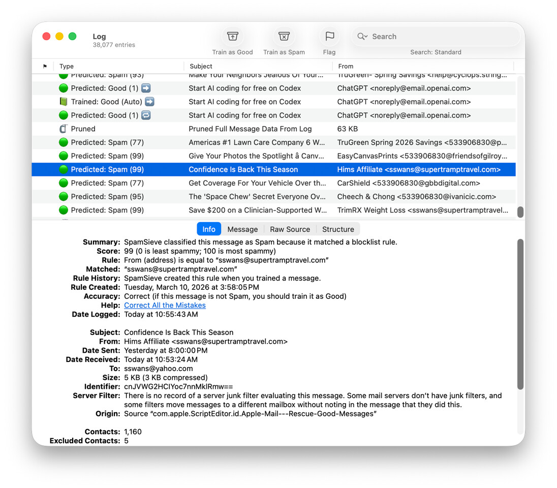

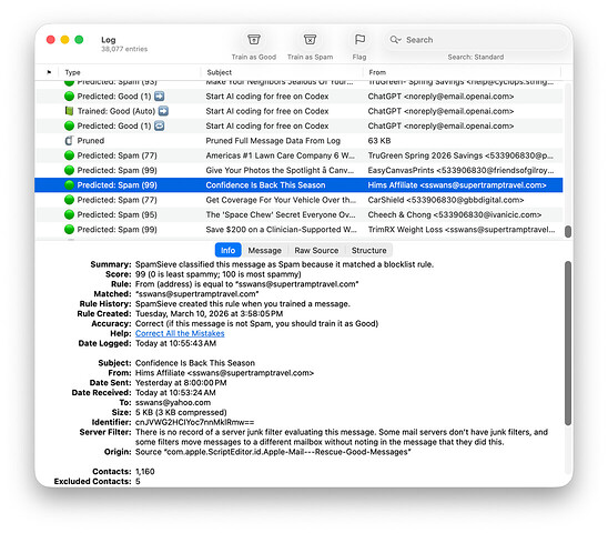

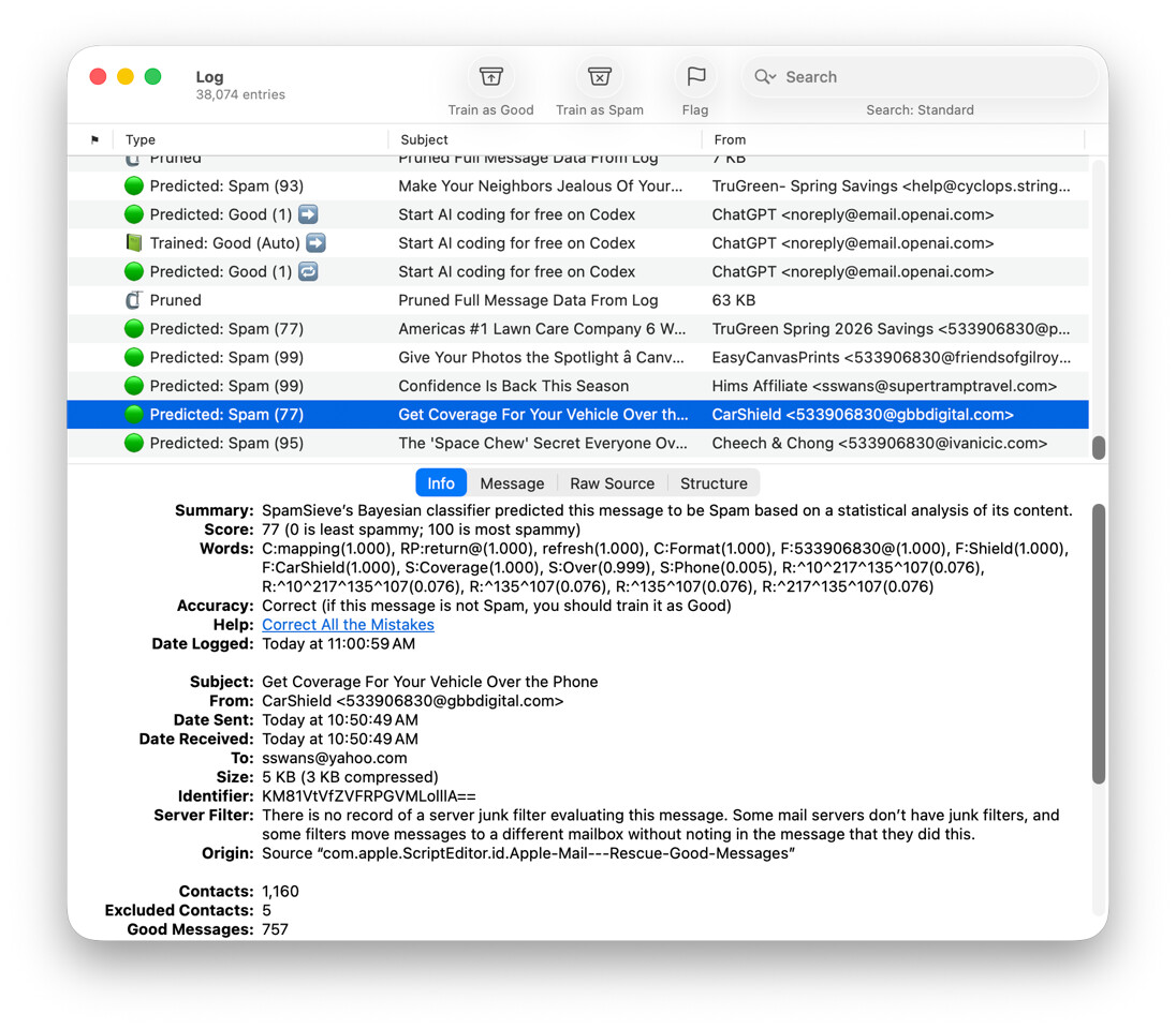

In the picture below, the older email is highlighted. It was received at 10:50:49 AM, and processed at 11:00:59 AM, 10 minutes later.
The email highlighted above should have been processed when the email highlighted below was processed, at 10:53:43 AM.

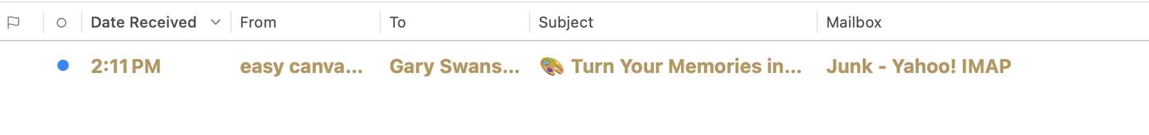

In this picture there are 2 emails in Junk. The first should have been already processed, and the second was processed a litlle later.
PastedGraphic-1.tiff
Now only the old Junk email is present.

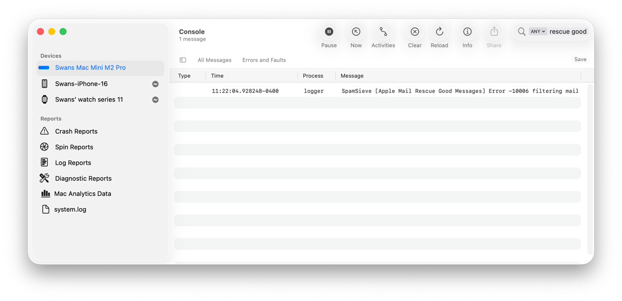

Here’s what’s in the Console window now:
So, the app is running, just running incorrectly and inconsistently.
It looks like Mail is reporting errors. If you click on the message in Console it should show some more information.

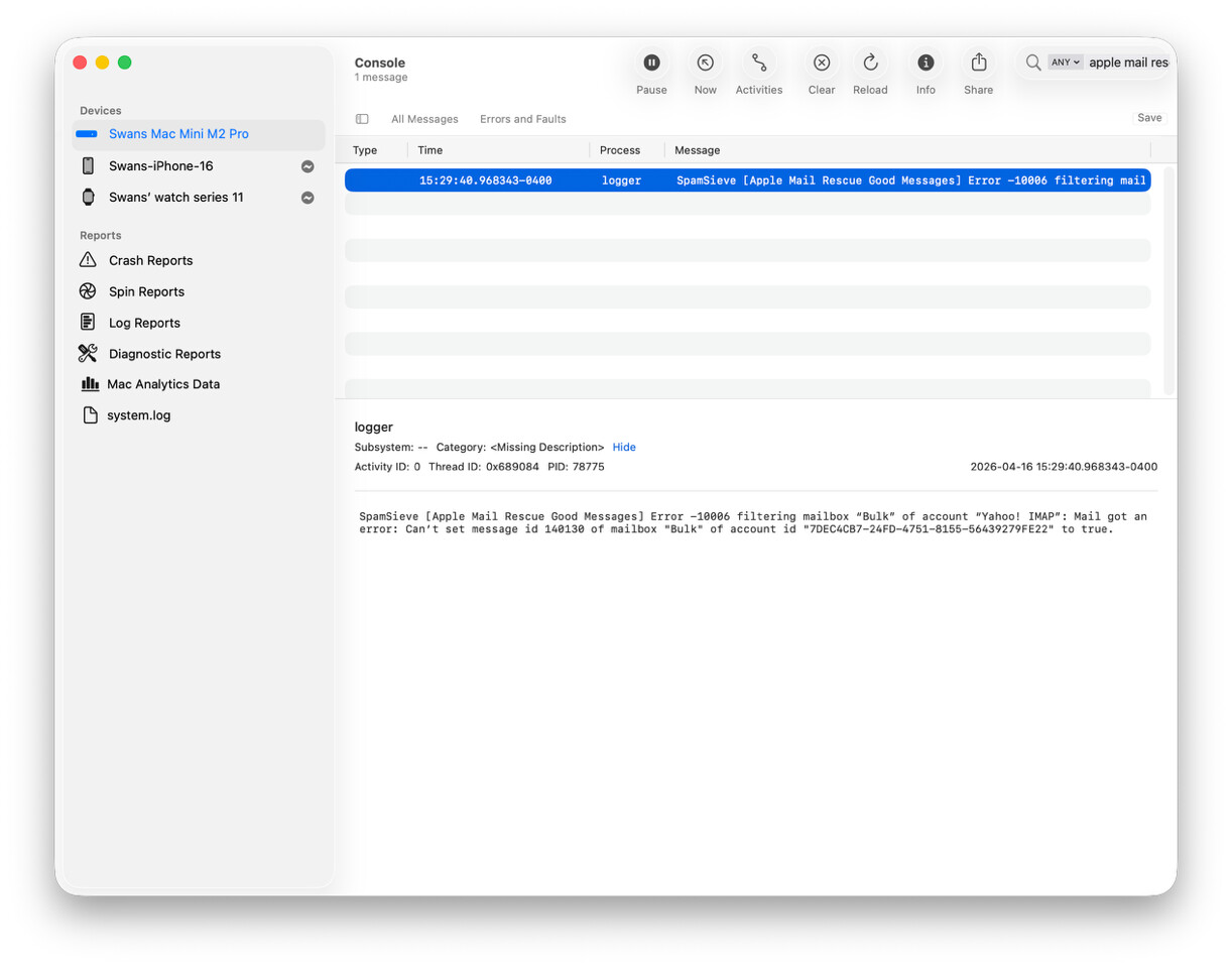

Sorry, I had paused and quit Console. The tardy email in Junk is now in the trash, and was processed 1/2 hour after it arrived and was skipped multiple times.
I’ll look for another skipped junk email and click on it if it happens again.

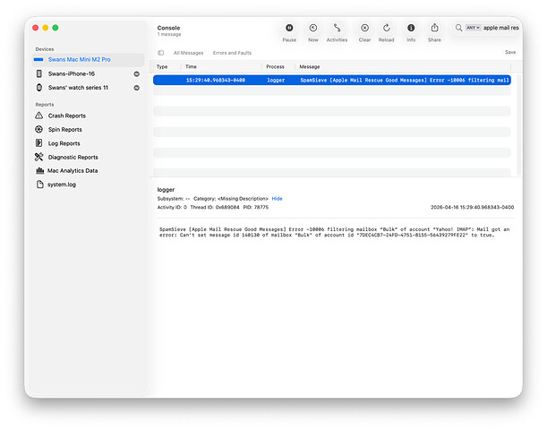

I got one. I have no idea what this means, but it processed properly. The spam was sent to trash.
This error typically means that some other software (or person) moved the message while SpamSieve was in the middle of working with it.
