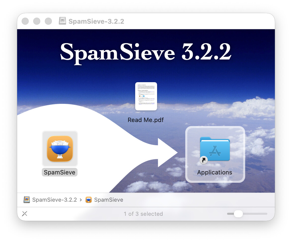

To downgrade to 3.2.2, do I need to first uninstall 3.3? I downloaded 3.2.2 and told it to replace 3.3, but when I check the version, it still says 3.3. I don’t want to lose the spam training that’s been done, so I want to be sure I correctly try the downgrade.

No, you can just quit and replace the old app file. Where are you still seeing “3.3”?

I still see 3.3 under “SpamSieve” (Top-left of screen next to the Apple logo when SpamSieve is the active application)→”About SpamSieve”. When I downloaded 3.2.2 (I confirmed this version as the installation window that lets me drag it to the Application folder says 3.2.2), then chose to replace the existing application (vs keep both) when prompted.
I just tried it again to be sure I did it correctly and got the same result.
It sounds like the file didn’t get replaced, for whatever reason. I suggest that you quit both Mail and SpamSieve and drag the old version to the trash before copying the new one into place.
I did just as you suggested (quit both Mail and SpamSieve, dragged the app from the Applications folder to the trash, then installed 3.2.2) and it still says version 3.3 is installed. Very odd.
I can’t imagine why it might make a difference, but I’ll try dragging SpamSieve to the trash, rebooting, then reinstalling.
  1. It turns out SpamSieve was installed in both my Applications folder and my Applications/Utilities folder. The version in the Utilities folder was the one being used. I’m not sure why it was in two locations, but I corrected this.
