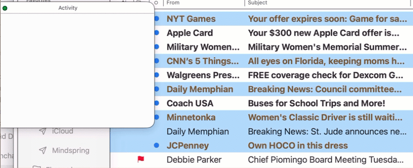

My wife’s MBPro (M4, 26.6.1, 24GB, unknown version of SpamSieve!) displays “All Messages” message list “jumps” every 30 seconds (timed and verified).
Jumping Mail Items 2
Not a big problem, but very distracting. Wife not happy!

It’s normal for SpamSieve to check the inbox repeatedly. It’s not really clear to me from the screen recording what’s “bouncing.” Is Mail adding new messages to the list? Are they spam or good?
You can check the Log window to see exactly what SpamSieve is doing. Is it processing messages that you didn’t expect?
The main thing I see is that you have a bunch of blue messages, which it looks like SpamSieve identified as spam but Mail failed to move out of the inbox. (This can happen if the Mail settings aren’t quite right.) Or perhaps it moved them and then something else moved moved them back

The “bouncing” is when SpamSieve seems to “move” a message to Junk or Spam and then ‘fails’ and puts it back into the original Inbox. It does this with every message that is UN-read. Each time a message is temporarily moved out of the Inbox, that list shrinks a bit causing items BELOW that message to move up. When the move fails, the message is put back into the list and the items list return to their original positions (moving UP or DOWN as needed.
I don’t know why there are “a bunch of blue messages”! :flushed_face: At first I thought you were referring to the “Unread” marker. Clearly that is not why they are blue.

This is what I was referring to above about Mail failing to move messages.
Presumably, it’s because of the spamminess score that SpamSieve assigned.
Since Mail is responsible for moving the messages, reinstalling SpamSieve is not going to change whether it’s successful at moving them or not. So perhaps there was a server issue that was coincidentally fixed around the same time. Anyway, I’m glad things are working now.
