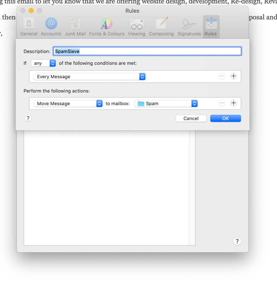

Thanks for sending the report. There are two issues:
Your mailbox needs to be renamed from SPAM to Spam.
Your SpamSieve rule in Mail needs to look like the picture below, i.e. say Every Message instead of From:
It looks like the rule is set up properly and that it is indeed moving messages to the Spam mailbox.
Most likely, you have a server junk filter that’s moving some spam messages to the Junk mailbox before they get to your Mac.
