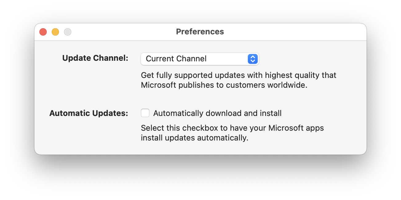

I think what happened is that you were signed up for the Current Channel (Preview) in Microsoft AutoUpdate. This will offer the 16.100.3 version that is not yet released. If you go to Outlook ‣ Help ‣ Check for Updates ‣ Advanced…, you can set the Update Channel to Current Channel, and then it will keep you on 16.100.2, which works with SpamSieve.
You can go back to 16.100.2 by downloading it from the App Store or by logging into your Microsoft account, clicking on View all subscriptions, and then clicking Install desktop versions of Microsoft 365 apps like Word, Excel, and PowerPoint to your device.:
Screenshot 2025-09-03 at 9.59.43 AM
This will download a standalone installer for version 16.100, which will auto-update to 16.100.2 if you are on Current Channel.

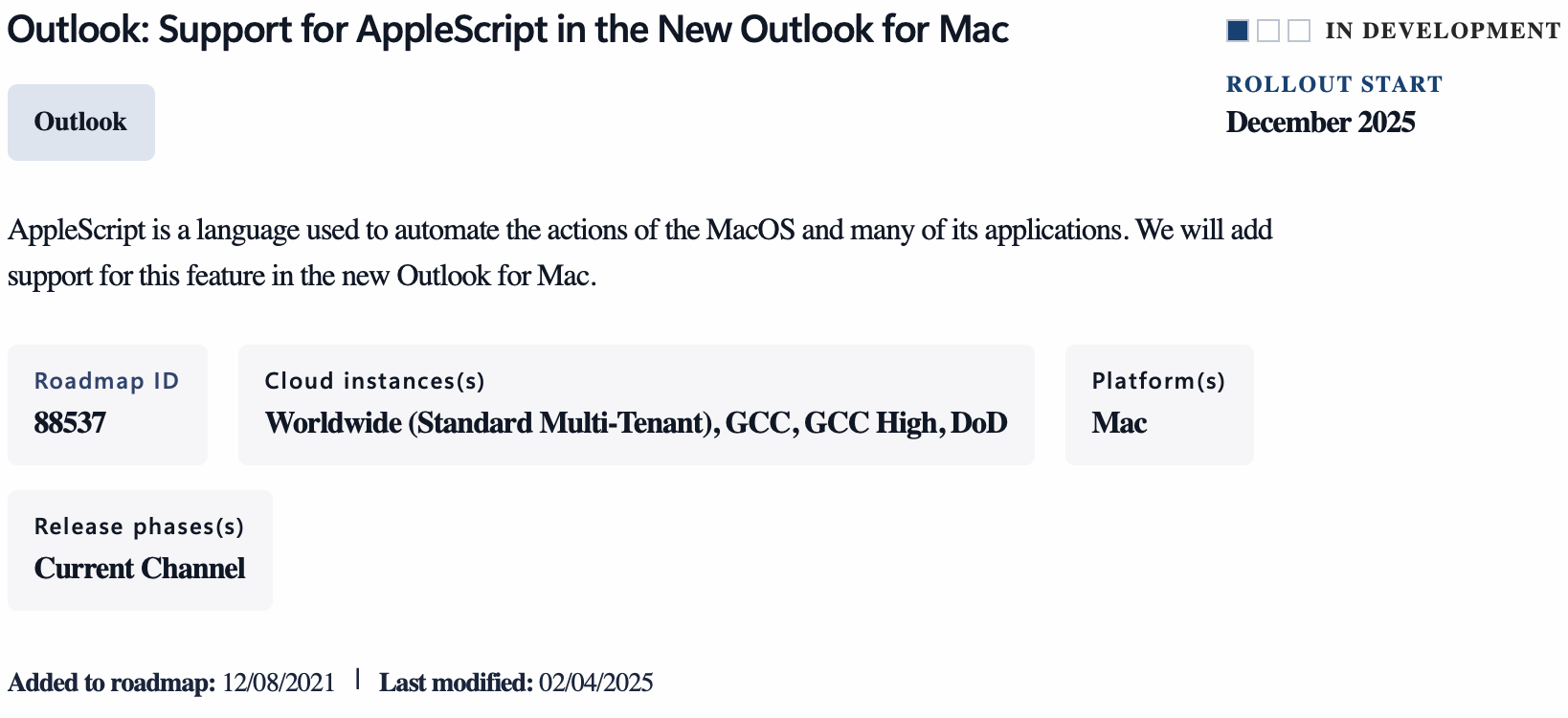

I talked with Microsoft, and they confirmed that they intend to support Legacy Outlook through October 31. At that point, New Outlook will not work with SpamSieve because it doesn’t yet support AppleScript, so there is no way for SpamSieve to access the message data. They originally said they would implement AppleScript support before discontinuing Legacy Outlook but now intend to add it back in December:
This functionality is not yet in beta, so we haven’t seen/tested it yet, but assuming that it works we should be able to restore SpamSieve’s support for Outlook at that time.

I am waiting for the Updater to finish. You were correct. I was on Current (Preview). I changed it to Current and am redownloading the programs. Right now it is stuck, but I have all the programs so I’ll let it sit. The App Store will not let me download the version that is there - 16.100.2. I have tried over a period of three days and it fails every time.
