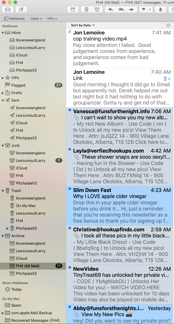

Meant to attach this… and another one popped in just as I was about to take a screen shot.
Also, here is how that mail is set up.
Please see Keeping Spam Messages Out of Gmail’s Archive.
YAY…
This email showed up in the IN-BOX. Let’s hope this keeps up!

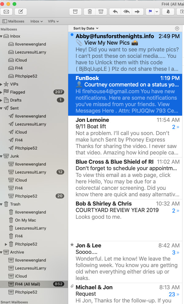

Hi Michael:
Back to using the old email address for the moment. Hopefully this gets squared away soon. So I seem to get no email at this address. It all goes to junk. FH4… all that website pix BS is gone it all goes into the FH4 archive mailbox along with duplicates of the inbox.
I have a few attachments for you to look at plus another diagnostic report. Obviously I have something done incorrectly that I can not seem to find out.
Thank you again for your time and effort for assisting me with this.
Jon
SpamSieve Diagnostic Report 3-20.tbz
